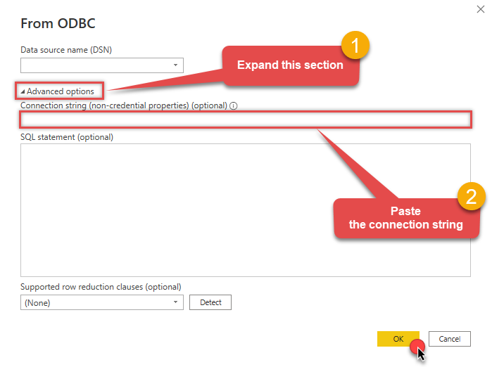

Import data using a SQL query
If you wish to import Stripe data from SQL query rather than a table then you can use advanced options during import steps (as below). After selecting DSN you can click on advanced options to see SQL Query editor.
StripeDSN
SELECT * FROM Products
Get REST API data in Power BI Desktop using SQL query and ODBC
Consider using Custom Objects feature in ODBC data source to encapsulate SQL query in a Virtual Table. This way, you can see a virtual table in Power BI table list where you can import multiple objects using the same connection rather than creating a new connection for each custom SQL query.

By default, Power BI imports Stripe data into its internal cache. However, if you require real-time data, you can use the DirectQuery mode.
Since the native Power BI ODBC connector limits you to Import mode, we must bridge the connection via Microsoft SQL Server. To do this, we configure the ZappySys Data Gateway and create a Linked Server pointing to it:

Using full ODBC connection string
In the previous steps we used a very short format of ODBC connection string - a DSN. Yet sometimes you don't want a dependency on an ODBC data source (and an extra step). In those times, you can define a full connection string and skip creating an ODBC data source entirely. Let's see below how to accomplish that in the below steps:
  1. Open ODBC data source configuration and click Copy settings:

  2. The window opens, telling us the connection string was successfully copied to the clipboard: Successful connection string copying for ODBC application
  3. Then just paste the connection string into your script:
    StripeDSN
    DRIVER={ZappySys API Driver};ServiceUrl=https://api.stripe.com/v1;CredentialType=Token;TokenAuthHeader=Authorization;
    Use full connection string in Power BI Desktop to read API data
  4. You are good to go! The script will execute the same way as using a DSN.
The DSN defined in the Data source name (DSN) field will be ignored.
